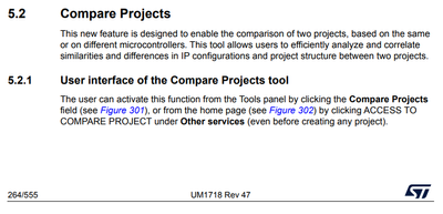

You can use a feature in STM32CubeMX that allows you to compare two projects by providing their .ioc files. This tool gives you a side-by-side comparative view of the configurations, which can help identify differences between the project provided in STM32_Hotspot and your project. It might help you spot any configuration mismatches causing the issue.

2025-06-24 2:55 AM - edited 2025-06-24 2:56 AM
@STackPointer64 wrote:You can use a feature in STM32CubeMX that allows you to compare two projects by providing their .ioc files. .
Ooh - a new feature!
Appears to have been added in 6.13.0 ?
#CubeMXCompareProjects #CompareIOC
