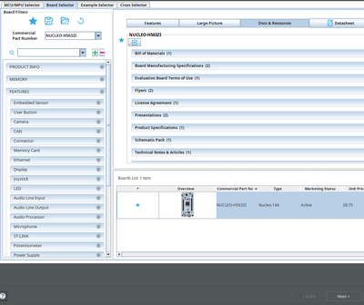

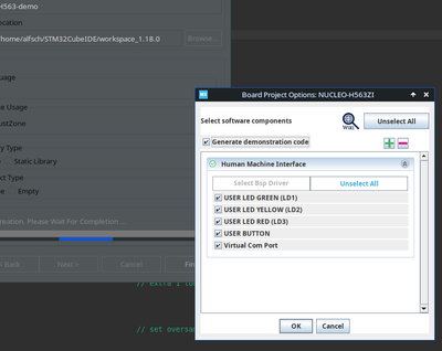

Try : new project..: select NUCLEO-H563ZI board
+ give it a name ...H563-demo ...or so, then :
check: generate demo..
...then try compile , debug...
