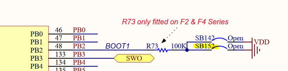

I solved it. ST have forgotten to set the propper state of the BOOT1 pin. I don't know why ST left BOOT1 floating.
I had to close SB152 (BOOT1 to ground), then it worked.

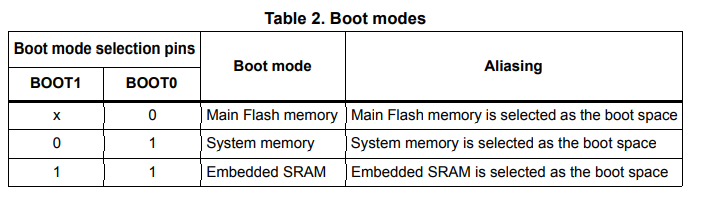

Hi @Community member ,
Thank you for your contribution.
The Schematic Pack is in line with the boot modes table described in the reference manual RM0090 and precisely in section 2.4.

> BOOT1 was kept floating in Nucleo-F429Zi in order to allow the user to select
A pull-up/down still allows the user to force the pin to the opposite level. If the BOOT1 would be pulled down through R73 100k by a closed SB152, then, when the user sets BOOT0=1, by default the MCU would boot the System bootloader, which is necessary more often that booting SRAM. But now it's unpredictable. And adding a 100k pull-down on one of the pins will rarely interfere with other usage of that pin even without disconnecting that pull-down.

The problem is also made a bit confusing by the fact that the same board MB1137 is not only used for F2/F3/F4/F7, but also for the STM32H743ZI. Of the STM32 used on the MB1137 only the STM32F2..F4 have a pin function BOOT1.
Regards
/Peter
2022-10-05 10:18 AM
If R73 is fitted only for F2/F4 parts, it would be logical to also fit the SB152 for the same parts. Not fitting it creates more issues and confusion than fitting it.
