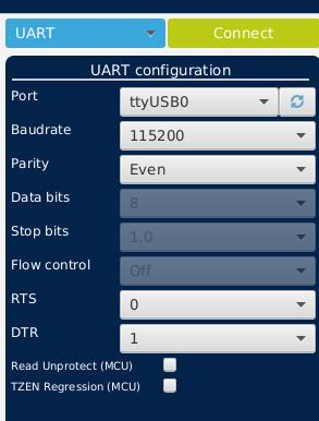

I am developing with Nucleo-F411RE Board an trying to use UART2 bootloader to flash my program.I use STM32CubeProgrammer to do this.when connect my board, ide report that Error: Activating device: KO. Please, verify the boot mode configuration and check the serial port configuration. Reset your device then try again...

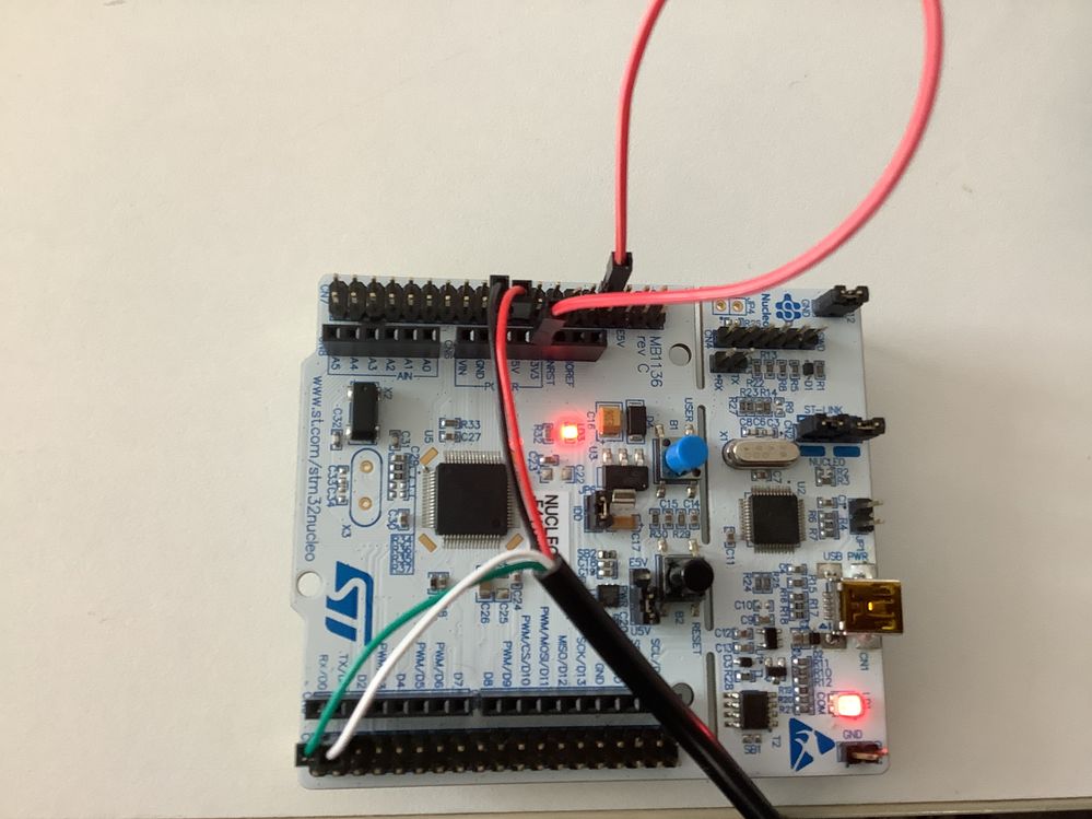

Here is my configure:
Start uart bootloader through ttl.TX(PA2),RX(pA3),BOOT0 3.3v,I can’t see BOOT1 on the board.

Hello @Blue Vincent and welcome to the Community :)
Make sure that you configure your board in bootloader mode and NRST is connected to the debugger.
Check the STM32F411xx bootloader configuration in system memory boot mode in the AN2606, and that bootloader is activated by applying Pattern 1 (described in Table 2: Bootloader activation patterns).
Imen

I did not configure NRST pin and I dont konw where is the debugger.
2022-09-14 2:56 AM
I did not configure NRST pin and I dont know where is the debugger, should I configure NRST to 3.3v?
