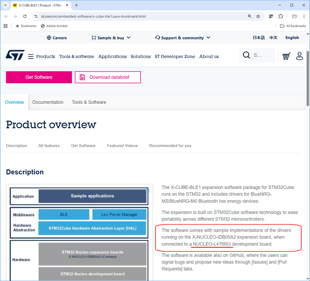

@BareMetaler wrote:
So you're saying that my NUCLEO-F401RE won't work to do a simple BLE demo?
Did you read the description of the X-CUBE-BLE1 ?
It says that the ready-to-go demo is for NUCLEO-L476RG - so you're going to have to do some work to adapt it for a NUCLEO-F401RE...
As @KnarfB said, HAL_Init() occurs very early in the system startup, so the problem is unlikely to be anything to do with the BLE - it won't have reached anything to do with that.
You need to find where & why it's going wrong in HAL_Init()
See also: Debugging Cortex-M Hard Faults

Andrew,
If you click the link I provided in my last post, you will see that it goes to the same page shown in the screen shot you've provided.
The sentence you've underlined has the term 'NUCLEO-L476RG'  yet both instructional videos at the bottom of the page only reference the NUCLEO-F401RE. One word vs 2 instructional videos. Please forgive my ignorance as I'm new here, but how is it intuitively obvious which one to use?
Just to clarify my own thinking, are you saying that if I use the NUCLEO-L476RG, that I would not have to go through the configuration process shown in the videos that use the NUCLEO-F401RE?
Thank you for your patience.
I see.
I don't know what's going on there, then.
If I use the NUCLEO-L476RG, do I  not have to go through the configuration process shown in the videos that use the NUCLEO-F401RE?
I'm just going by the text I highlighted - it suggests that there is a ready-to-go example for NUCLEO-L476RG.
As I said before, that doesn't mean that the X-NUCLEO-1DB05A1 cannot be used on any other Nucleo - just that some extra work may be required.
Have you studied the User Manual UM1873, "Getting started with the X-CUBE-BLE1 Bluetooth Low Energy software expansion for STM32Cube" ?
https://www.st.com/resource/en/user_manual/um1873-getting-started-with-the-xcubeble1-bluetooth-low-energy-software-expansion-for-stm32cube-stmicroelectronics.pdf
via: https://www.st.com/en/embedded-software/x-cube-ble1.save-bookmark.html#documentation
