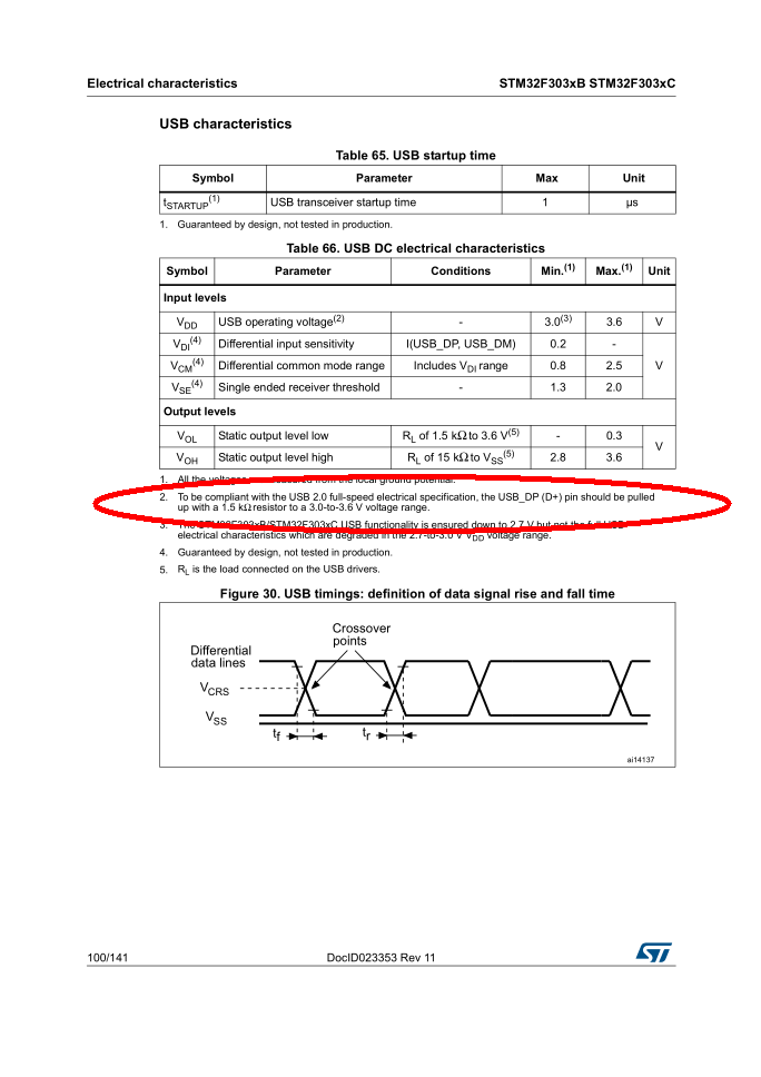

Ahhh! Excellent, thanks. Is this documented anywhere?
