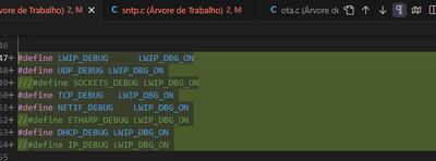

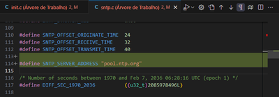

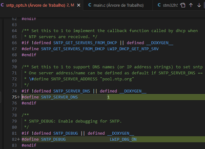

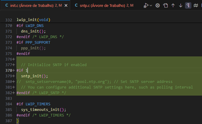

Here are some changes I made to the code in an attempt to implement SNTP:
File sntp.c:
File init.c

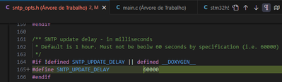

File sntp_opts.h
File lwipopts_freertos.h

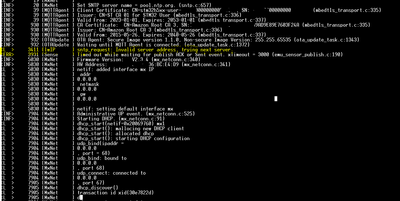

When running the code, I see the following log:

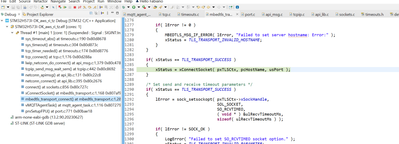

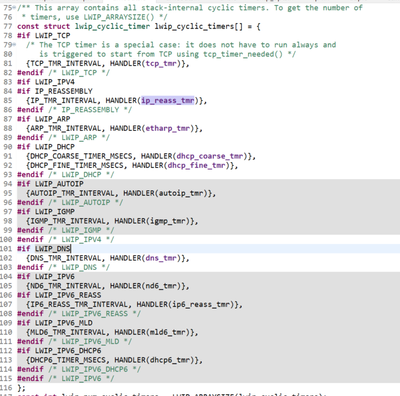

I noticed that when I debug the code, I get stuck on the following:
It's possible that this issue is related to this struct, however, I'm still investigating.
