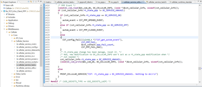

CST: New State: CST_PPP_CONFIG_ON_GOING_STATE
CST: rt_state_ppp = DC_SERVICE_UNAVAIL. Nothing to do
CST: autom_event = no event

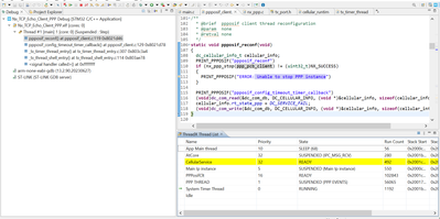

Here is the end log
I am not sure why nx_ppp_stop is resulting 11, in the ppposif_reconf(ppposif_config_timeout_timer_callback)
Need some inputs here, I was able to get the CONNECT from the SIM Modem
PPPosif:ppposif_client_config
IPC:IPC select 0x20019200
PPPosif:PPP is now created
PPPosif:ppposif_reconf
PPPosif:ERROR: nx_ppp_stop:11
PPPosif:ERROR: Unable to stop PPP instance
PPPosif:ppposif_config_timeout_timer_callback
