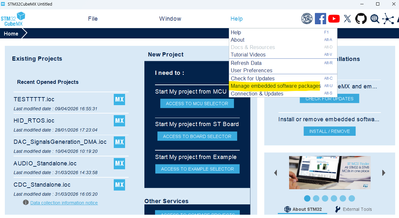

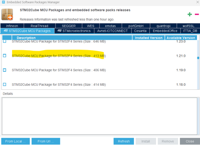

2026-04-13 8:34 AM
Hello @devminer
Welcome to the ST Community. For this point, you can download the version from STM32CubeMX.
Best regards,
Hamdi

2026-04-13 8:51 AM
Thank you very much! I forgot to check there.

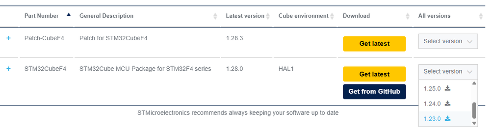

2026-04-13 9:01 AM
@devminer wrote:Do you know if there's a reason why these versions aren't available on the website?
Current version is 1.28.0 ; There are versions back to 1.23.0 on the website:
I guess they though that was far enough back?
This is why I would always keep the download with the project!
2026-04-14 1:31 AM - edited 2026-04-14 1:31 AM
Hello @devminer
The first version published on GitHub is 1.24.1. The older versions were published only on st.com and in STM32CubeMX.
