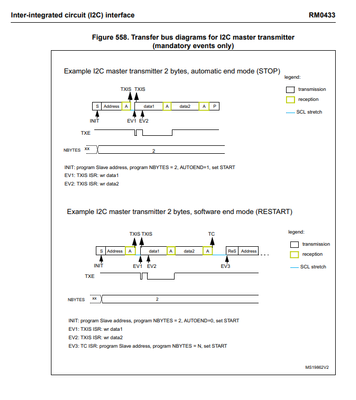

2025-07-11 1:48 AM
Hello @TomC1
Please refer to the RM0433 to check the transfer bus diagrams.
As @MM..1 mentioned the HAL functions expect the address to be left-shifted by 1 bit.
