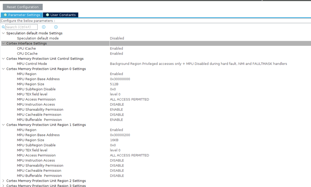

I use the H723ZG Nucleo board without FreeRTOS. I had configured Ethernet for the H723ZG in the past. But I am unable to configure it again now, even when following the same steps. When I first got it working, my configuration was based on this Youtube video STM32 ETHERNET #1. Hardware Configuration || PART 1.
In addition, I spent countless days trying to configure the Ethernet without FreeRTOS based on this post How to create project for STM32H7 with Ethernet and LwIP stack working from @Adam BERLINGER . I was able to get it working WITH FreeRTOS, but not WITHOUT it. And I am here to kindly ask for your help.

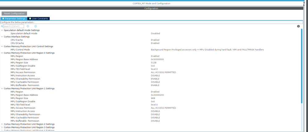

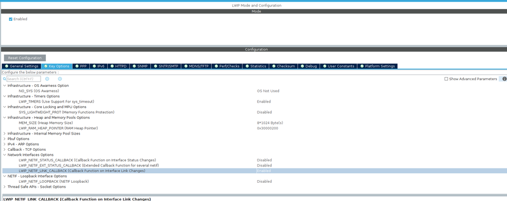

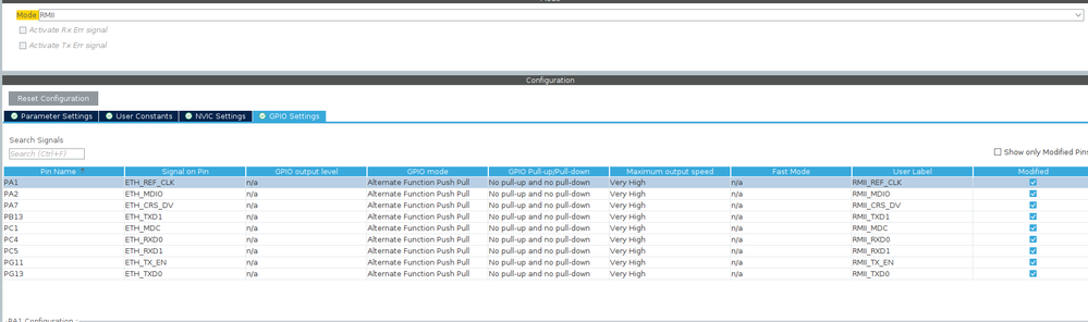

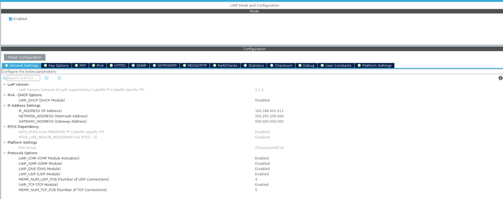

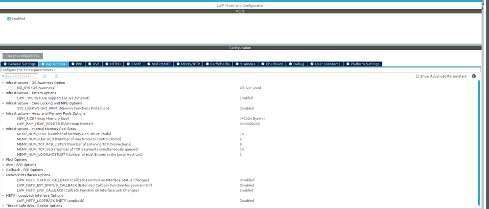

Here are some screenshots from my `.ioc` file.
I am testing it with the ping example.

=== EDIT START
I noticed that in the MPU I was requestion 16 KBytes starting from 0x30000200 and I had the LWIP MEM_SIZE as 8 KBytes. I decided to change both, and I got a HardFault.
=== EDIT END

Hello @eduardo_reis ,
At first glance it seems like you are missing this call in the while(1);
Ethernet_Link_Periodic_Handle(&gnetif);
The MPU configuration should be as follows following the example found in the cube firmware :
static void MPU_Config(void)
MPU_Region_InitTypeDef MPU_InitStruct;
/* Disable the MPU */
HAL_MPU_Disable();
/* Configure the MPU attributes as Device not cacheable
for ETH DMA descriptors */
MPU_InitStruct.Enable = MPU_REGION_ENABLE;
MPU_InitStruct.BaseAddress = 0x30000000;
MPU_InitStruct.Size = MPU_REGION_SIZE_1KB;
MPU_InitStruct.AccessPermission = MPU_REGION_FULL_ACCESS;
MPU_InitStruct.IsBufferable = MPU_ACCESS_BUFFERABLE;
MPU_InitStruct.IsCacheable = MPU_ACCESS_NOT_CACHEABLE;
MPU_InitStruct.IsShareable = MPU_ACCESS_NOT_SHAREABLE;
MPU_InitStruct.Number = MPU_REGION_NUMBER1;
MPU_InitStruct.TypeExtField = MPU_TEX_LEVEL0;
MPU_InitStruct.SubRegionDisable = 0x00;
MPU_InitStruct.DisableExec = MPU_INSTRUCTION_ACCESS_ENABLE;
HAL_MPU_ConfigRegion(&MPU_InitStruct);
/* Configure the MPU attributes as Normal Non Cacheable
for LwIP RAM heap which contains the Tx buffers */
MPU_InitStruct.BaseAddress = 0x30004000;
MPU_InitStruct.Size = MPU_REGION_SIZE_16KB;
MPU_InitStruct.IsBufferable = MPU_ACCESS_NOT_BUFFERABLE;
MPU_InitStruct.IsShareable = MPU_ACCESS_SHAREABLE;
MPU_InitStruct.Number = MPU_REGION_NUMBER2;
MPU_InitStruct.TypeExtField = MPU_TEX_LEVEL1;
The GPIO configuration should be as follows :
void HAL_ETH_MspInit(ETH_HandleTypeDef *heth)
GPIO_InitTypeDef GPIO_InitStructure = {0};
/* Ethernett MSP init: RMII Mode */
/* Ethernet pins configuration */
RMII_REF_CLK ----------------------> PA1
RMII_MDIO -------------------------> PA2
RMII_MDC --------------------------> PC1
RMII_MII_CRS_DV -------------------> PA7
RMII_MII_RXD0 ---------------------> PC4
RMII_MII_RXD1 ---------------------> PC5
RMII_MII_RXER ---------------------> PB10
RMII_MII_TX_EN --------------------> PB11
RMII_MII_TXD0 ---------------------> PB12
RMII_MII_TXD1 ---------------------> PB13
/* Enable GPIOs clocks */
__HAL_RCC_GPIOA_CLK_ENABLE();
__HAL_RCC_GPIOB_CLK_ENABLE();
__HAL_RCC_GPIOC_CLK_ENABLE();
/* Configure PA1, PA2 , PA7 */
GPIO_InitStructure.Pin = GPIO_PIN_1 | GPIO_PIN_2 | GPIO_PIN_7;
GPIO_InitStructure.Speed = GPIO_SPEED_FREQ_HIGH;
GPIO_InitStructure.Mode = GPIO_MODE_AF_PP;
GPIO_InitStructure.Pull = GPIO_NOPULL ;
GPIO_InitStructure.Alternate = GPIO_AF11_ETH;
HAL_GPIO_Init(GPIOA, &GPIO_InitStructure);
/* Configure PB10, PB11, PB12 and PB13 */
GPIO_InitStructure.Pin = GPIO_PIN_10 | GPIO_PIN_11 | GPIO_PIN_12 | GPIO_PIN_13;
HAL_GPIO_Init(GPIOB, &GPIO_InitStructure);
/* Configure PC1, PC4 and PC5 */
GPIO_InitStructure.Pin = GPIO_PIN_1 | GPIO_PIN_4 | GPIO_PIN_5;
HAL_GPIO_Init(GPIOC, &GPIO_InitStructure);

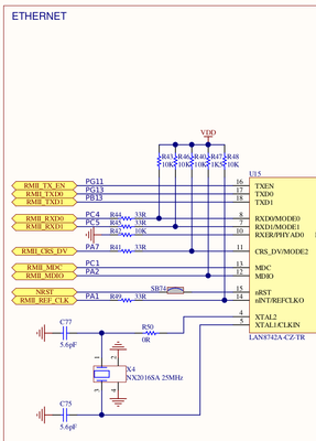

Also, the schematics I have for my board (below)
points to a different pin assignment than the ones you gave in
