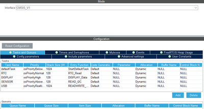

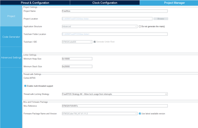

2024-07-05 10:22 PM
Hello @nouirakh
I increased the stack size and heap size as you can see. and also change the default task that MX_USB_HOST_Init(); is in there. but nothing happened.
Is this the place to increase stack size that you mentioned?
ap size in
2024-07-08 1:46 AM
Hello @AMIR-F-O
You can change the stack sizes using STM32CubeMX by following these steps:

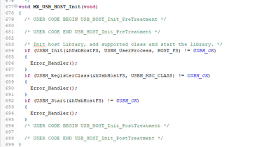

I have some question for be sure that I have no bug on Cube IDE.
1. is there any visible task when generating code for USB_USE_OS?
2. Do I need function to run USB in tasks?
3.this is code generated Initializing USB is it ok?

Code generated Initializing USB is it ok?
Open the usb_host.c file and look for the task creation code. It should look something like this:

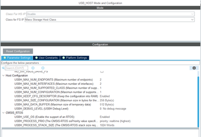

2024-07-08 3:32 AM
Thankyou @nouirakh
the Code Below show all script of my "usb_host.c" that code generator made it.
So this is the problem. code generator has bug for me. I am using CUBE IDE 1.15.1. what should I do for this issue? or should I add some code manually into it!
