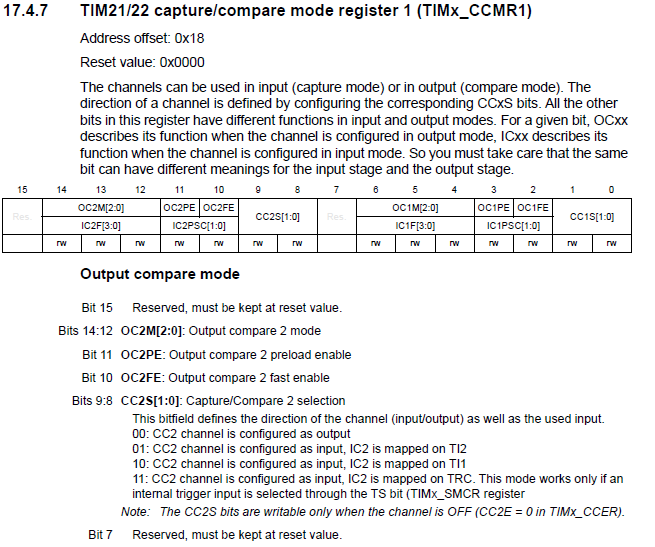

If i'm correct, this function sets the bit 15 of TIM21_CCMR1 register, that in the Refernce manual (RM0377 - DocID025942 Rev 8) is declared "Reserved, must be kept at reset value."
So the question is: Is the Low level driver correct and in the manual there is something missing, or that bit must be left clear and the driver si doing something wrong?

I agree to you, but, the strange thing is that the functionality is described in the reference manual, the only thing that is missing is the bit description in the timer registers paragraph.
In the stm32l011xx.h file (that is specific for this uc) the bit is exposed via this define, even if it is undocumented:
#define TIM_CCMR1_OC2CE_Pos      (15U)
#define TIM_CCMR1_OC2CE_Msk      (0x1UL << TIM_CCMR1_OC2CE_Pos)               /*!< 0x00008000 */
#define TIM_CCMR1_OC2CE          TIM_CCMR1_OC2CE_Msk                         /*!<Output Compare 2 Clear Enable */
Calling the function that uses the defines above reported, it makes all work correctly...
For that reasons I thought that it was a documentation issue... my intention was to report the matter for a possible correction and obtain, in the meanwhile, confirmation of my hypothesis, just to be sure I'm using the timer in the correct way.
Just to complete the information, this is the screenshoot of the manual:
Paolo Andreuzza
Associate II
So, please, is there anybody that knows if the bit 15 of TIM21_CCMR1 register can be used to clear the OC2REF signal on an external event, as written in the description paragraph, or it must be left clear, as written in the register description?
