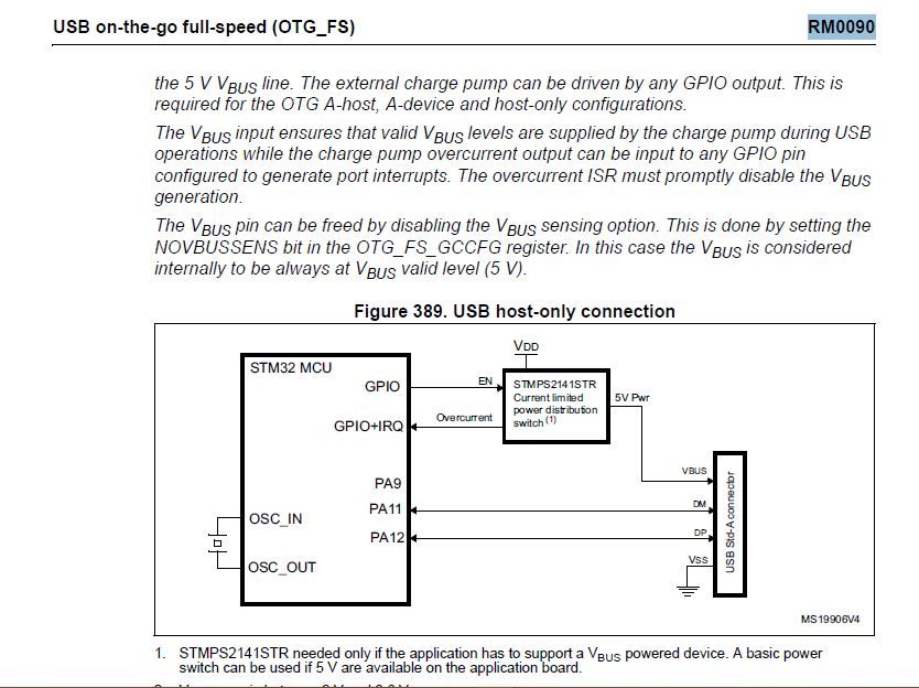

does anyone draw a circuit to get the stm32F4 MCU with USB connector working properly .

Inside reference manual there is a minimum "schematic" for OTG USB FS in Host mode.
F4 series has an internal FS PHY.
I tried it and it works properly.
Although EMI filters and ESD protection, both are recommended.
Most cheap Chinese F407VG boards use this minimal configuration.
