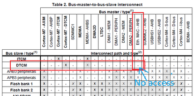

I'm not an ETH expert but seems the heap is used by one of DMA1/DMA2 masters that does not have access to DTCM RAM.
From RM0399 reference manual:
EDIT: I forgot to mention the ETH master which also doesn’t have access to the DTCM.

Several masters such as DMA1, DMA2, ETH (used in your case) etc .. don't have access to DTCM RAM. Look at the table 2 in the RM0399 I've already shared.
I've already edited my previous post.

I confirm SofLit's post, the ETH DMA (neither any other DMA :( ) cannot access DTCM.
I had to place it in D1 AXI SRAM (H7xx).
