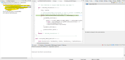

I have a problem while using lwip and freertos.
The board is based on stm32h743vih.
The mpu configuration is done correctly i think.
My problem is after i start udp server and start to send data with udp, everything is ok, but after a while i will enter a loop in xQueueSemaphoreTake an in the configASSERT( pxQueue->uxItemSize == 0 ).
