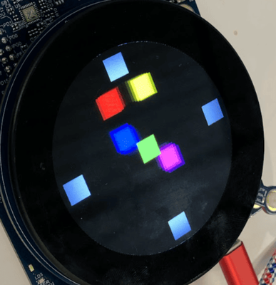

It seems I managed to solve some problem. I added 2 GFXMMU buffers and shifted pointer of LTDC each line event entering blanking. It is working fine, but now I have 2 other problems:
  • how to lower frequency of LTDC? I cannot achieve less than 70 framerate. I need 30FPS.
  • how to fix ghosting effect? When drawing moving object it leaves trail behing.
Here green square is static. White ones are blinking. Rest are moving and leaving train behind.
With slowmotion camera it is visible that pixel color is not turning of completly when blinking. It is somehow delayed.
Btw, there is completly no documentation for the display. Part number leads to chineese website without any further information. The display doesn't exist in the offer.
I tried divinding framerate with software and ghosts are less visible
