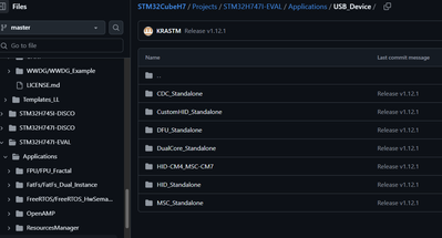

But I cannot find "Audio_Standalone" example in ./Projects/STM32H747I-EVAL/Applications/USB_Device/ folder.
To me, it seems like under :

2025-06-04 3:49 AM
Hi again @skson
Some middleware libraries along with the projects are not available on Github. You can find them directly when downloading from STM32CubeH7.
