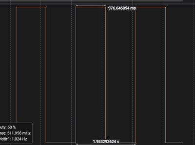

I have a project with similar requirements. that runs on a Nucleo U083RC board
LPTIM1 (at LL level) is clocked by the LSE.
You can use this project as a reference to identify the root cause of your problem.
The project is configured to toggle the PC3 pin every ~one second.
PSC is set to 2, and ARR is set to 16000.
Here is the code sequence that you need to implement to start the timer
 /* USER CODE BEGIN LPTIM1_Init 2 */
  LL_LPTIM_Enable(LPTIM1);
  LL_LPTIM_ClearFLAG_ARRM(LPTIM1);
  LL_LPTIM_EnableIT_ARRM(LPTIM1);
  LL_LPTIM_StartCounter(LPTIM1, LL_LPTIM_OPERATING_MODE_CONTINUOUS);
  /* USER CODE END LPTIM1_Init 2 */

I observed something interesting when comparing behavior between HAL and LL RCC initialization, even though both projects use STM32CubeMX-generated code.
What I’m seeing
  • When RCC is initialized using the HAL-generated code, LPTIM works correctly with LSE even after a Power-On Reset (POR).
  • When I switch to the LL-generated RCC code (from CubeMX, not handwritten), LPTIM stops working after a POR.
  • If I first flash the version with HAL RCC init, then reflash the LL version without removing power, LPTIM continues to work.
  • But after a true POR, LPTIM no longer runs.
