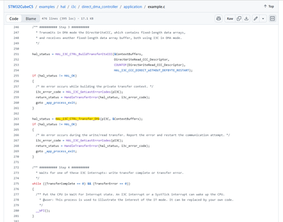

Please take a look at the example direct_dma_controller, which use HAL_I3C_CTRL_Transfer_DMA.

Yes, I am familiar with that example, but that's not what I had in mind. The example you indicated shows the use of DMA for Command Command Codes (CCC). What I am looking for is an example of private transfers.
