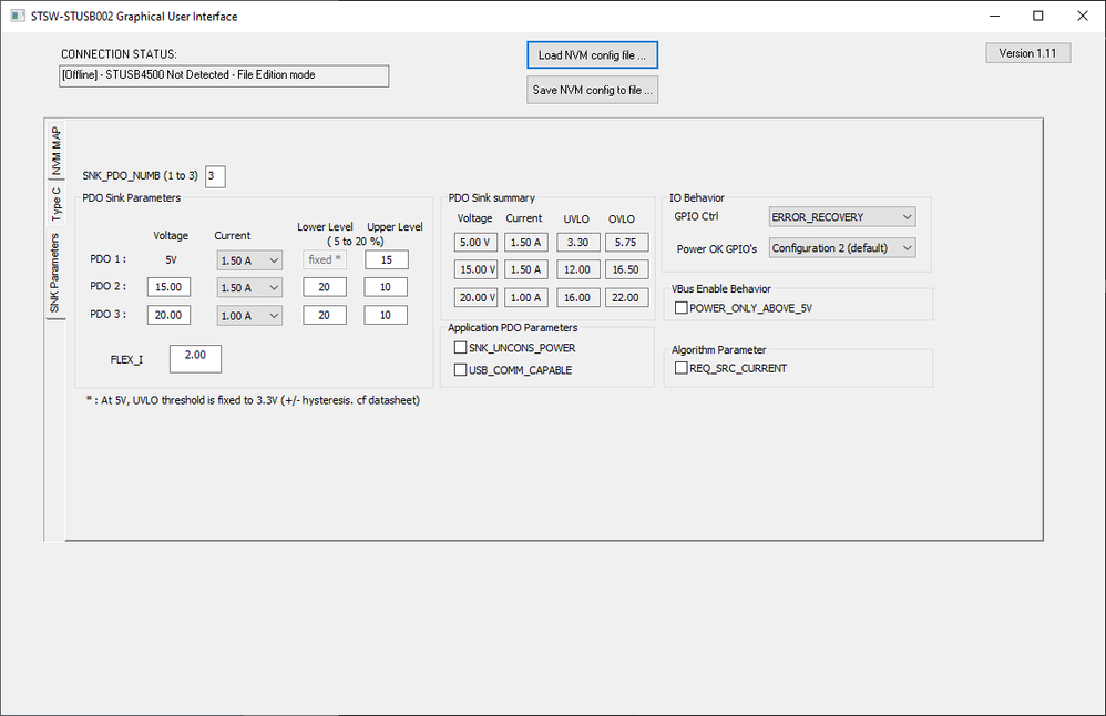

Do you get a "SINK PARAMETERS" page on the V1.11 GUI, like on the V1.09 one?
I don't.

And to answer your first question, I do get the SINK PARAMETERS page on v1.11.

So you do get the "SINK PARAMETERS" page on V1.11. I don't know what's wrong with my Windows 10 installation.

Yes, I do get the "SINK PARAMETERS" page on v1.11. I took a screenshot and it is above.
