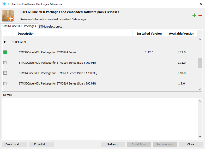

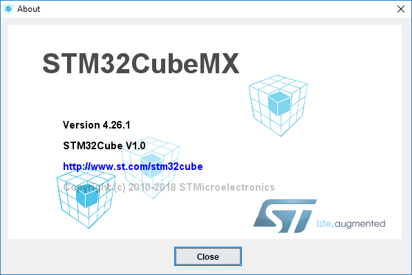

Here is my CubeMX version:
Here is my L4 libs version:
