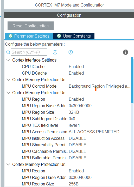

1-Mpu Configuration:

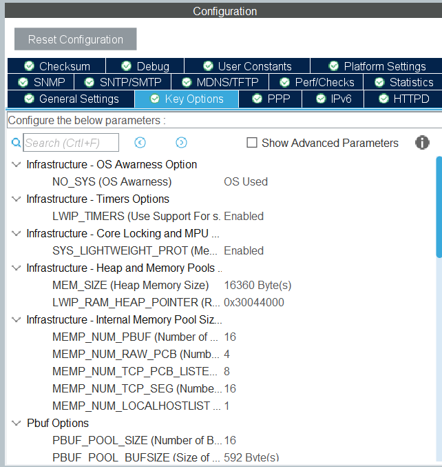

3- Lwip Configuration:
LWIP_NETIF_LINK_CALLBACK enabled.
