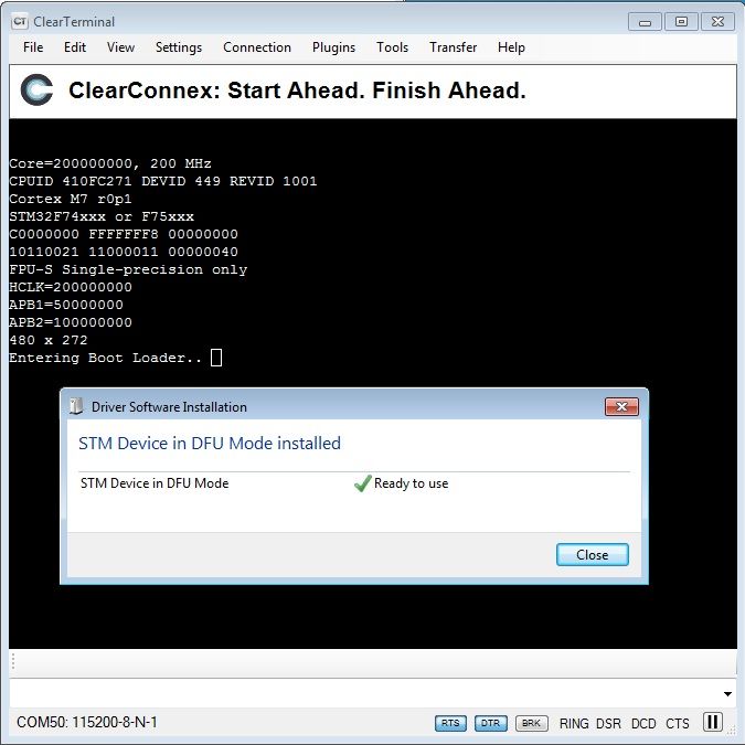

2018-09-11 8:22 AM
Well the forum transition seems to have made a dog's breakfast of the original post, and is apparently too large and malformed to bring up the editor window.
This brought up 'STM32 BOOTLOADER' on the STM32F746G-DISCO for me
void BootDFU(void)
printf("Entering Boot Loader..\r\n");
SCB_DisableDCache();
*((unsigned long *)0x2004FFF0) = 0xDEADBEEF; // 320KB STM32F7xx
__DSB();
NVIC_SystemReset();
