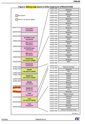

One more thing, what is RAM_START and RAM_END? I'm using a STM32U585 MCU.
Thank you!
2025-10-21 3:48 AM - edited 2025-10-21 4:04 AM
The RAM_START and RAM_END are defined in your linker file. For example, it in the stm32u585xx_flash.icf file on the B-U585I-IOT02A examples it is defined as below.
define symbol __ICFEDIT_region_RAM_start__ = 0x20000000;
define symbol __ICFEDIT_region_RAM_end__ = 0x200BFFFF;
