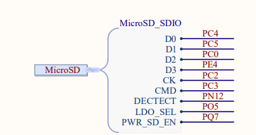

After checking the schematics, I noticed that the CK pin was incorrect, so I assigned the correct pin (PC2:(

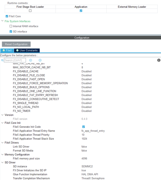

  • Enabled FileX with mostly default settings, except for increased memory and FX driver initialization:
