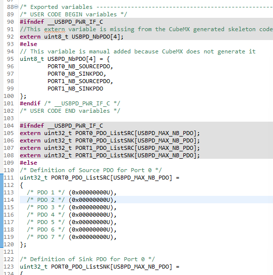

I am using the STM32CubeMX ver 6.13.0 to generate a USB-PD DRP application. After generating the code following this procedure for custom boards (https://wiki.stmicroelectronics.cn/stm32mcu/wiki/STM32StepByStep:Getting_started_with_USB-Power_Delivery_Dual_Role) I see that the file "usbpd_pwr_if.c" is defining the following macro "#define __USBPD_PWR_IF_C" first thing, than including the necessary header files. One of the header files, "usbpd_pdo_defs.h", is using the __USBPD_PWR_IF_C to check if there is the need to initialize the list of SRC/SNK PDOs or get them as externs. The issue is that even though the __USBPD_PWR_IF_C is defined and the "usbpd_pdo_defs.h" header is included after the definition, the "usbpd_pdo_defs.h" header file is not seeing the definition and is enabling the necessary code as if the macro __USBPD_PWR_IF_C was not defined.
Any possible reasons for this behaviour?

Hi TDK,
I regenerated using the latest CubeMX but gave the same result. While __USBPD_PWR_IF_C is defined in usbpd_dpm_user.c, the usbpd_pdo_defs.h is not finding it as can be seen from the image below. I included the IOC file as requested.
Note: In my project, I disabled the GUI_INTERFACE, TRACER_EMB and RTOS as I won't be using them. Moreover, in the X-CUBE-TCPP section, I unchecked "Board Part tcpp0203" as this is a custom board which wont be using it. I left "Device USBPD Application" checked in order to populate the xx_user.c files with the necessary code for USBPD.

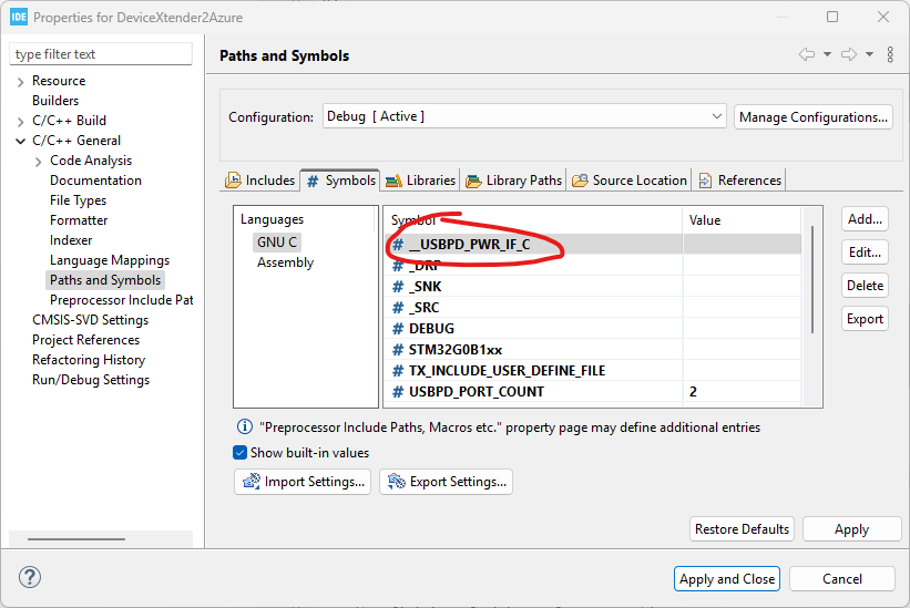

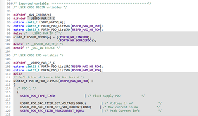

In addition to @DDeba.1 findings I like to add related topic.
One could add the #define __USB_PWR_IF_C as symbol for the compiler as below.
So that the compiler will compile the variables in the uspd_pdo_defs.h file and no longer makes use of the externs.

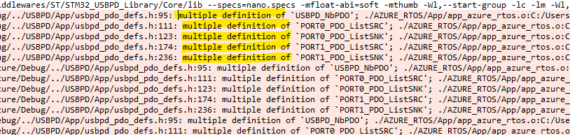

But then the linker start complaining about multiply definitions in h file and object file.
Meaning something is definitely not correctly implemented in the CubeMX generated skeleton code.
