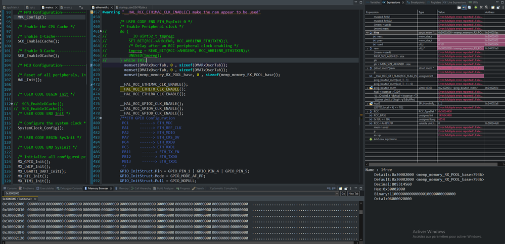

I'm having issues with the Heap of the LWIP that is used/full, and I can't do any mem_malloc.
I have dig a bit on why the log of LWIP tells me that it couldn't allocate memory ("etharp_raw: could not allocate pbuf for ARP request"). As far as i understand, the mem_malloc used the struct mem *lfree variable to handle the allocation for the LWIP and which is the next/previous chuck and also if the next chunk is being used or not.
struct mem {
/** index (-> ram[next]) of the next struct */
mem_size_t next;
/** index (-> ram[prev]) of the previous struct */
mem_size_t prev;
/** 1: this area is used; 0: this area is unused */
u8_t used;
#if MEM_OVERFLOW_CHECK
/** this keeps track of the user allocation size for guard checks */
mem_size_t user_size;
#endif
My issue is that the variable used in the mem struct is never null or zero. Which lead to the mem_malloc to always return NULL even after a fresh upload or power up.

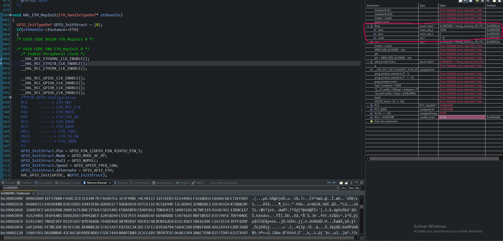

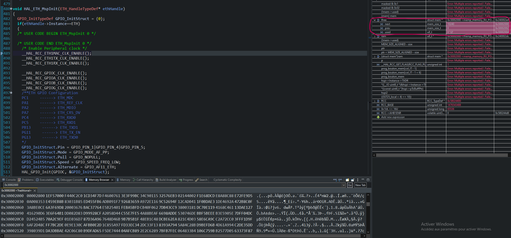

I manage to track down what appear to be written in the memory area dedicated for the LWIP heap. It occurs in the HAL_ETH_MspInit ("void HAL_ETH_MspInit(ETH_HandleTypeDef* ethHandle)") with the line "__HAL_RCC_ETH1MAC_CLK_ENABLE();" as you can see in the picture
> FAV_After-__HAL_RCC_ETH1MAC_CLK_ENABLE.PNGFAV_After-__HAL_RCC_ETH1MAC_CLK_ENABLE.PNG
Before the call, the ram is zero, after the call the ram is full. You can also see in the Expressions panel on the right that before the call, lfree is empty, and after the call lfree is not empty anymore and point to some random chunk.
The really strange thing is that the same code can work for a while, but once the ram is used, i'm stuck.
I'm using the STM32H743ZI on a custum PCB with the LAN8742 .
I also tested the same code on the Nucleo-H743ZI2 and i'm having difference result with the same function
> Nucleo-After-__HALL_RCC_ETH1MAC.PNGTCP_OK_Nucleo-After-__HALL_RCC_ETH1MAC.PNG
As you can see with the nucleo, the ram is not null/zero before the call and after the call as well, but the field "used" is zero, and i can therefore call mem_malloc without any issue.

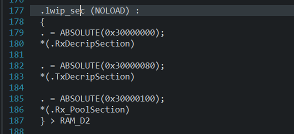

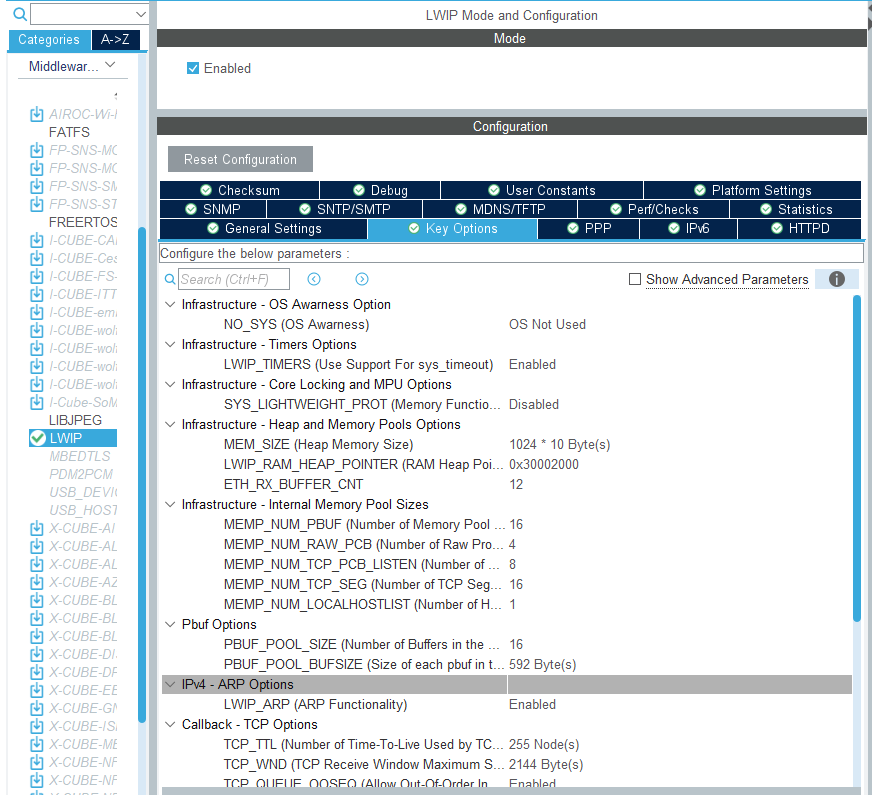

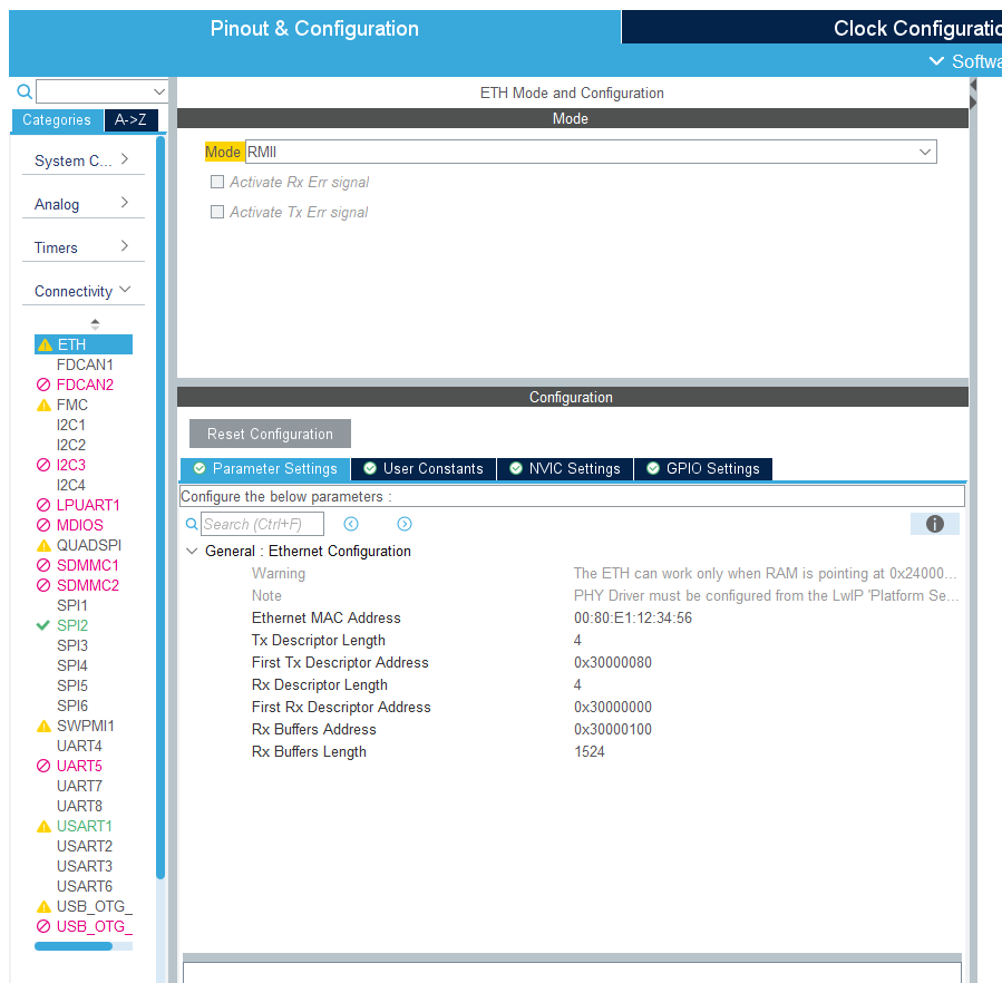

I'm providing you the ETH_ICO config, the LWIP_ICO config, and the change i made in the FLASH.ld
For the LWIP and ETH configuration in the ICO, I have follow this guide/serie :

2024-09-27 6:19 AM
It's hard to figure out what is wrong there. For best result, zero all the mentioned areas in your init code (descriptors memory, LwIP pool, buffers).
2024-09-27 6:56 AM

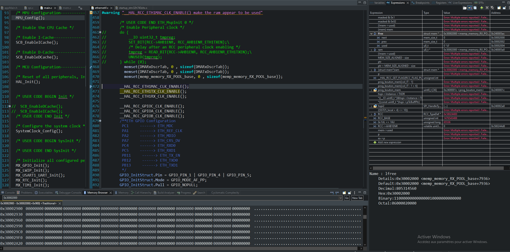

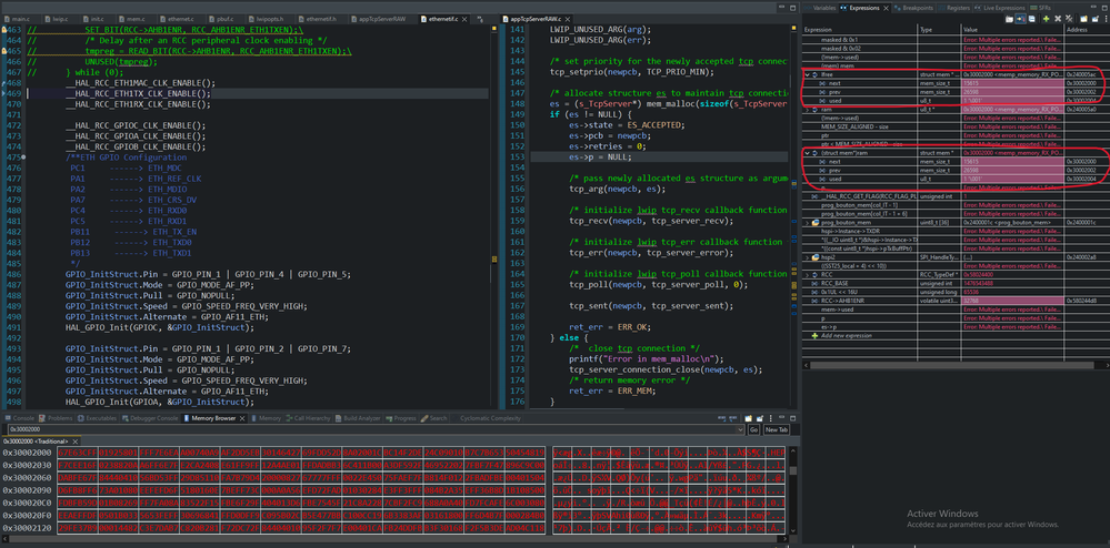

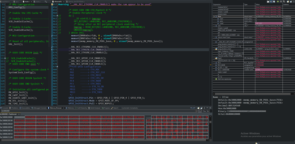

Sure, here is the picture before the memset of the three arena declar in the flash.ld :
After the memset but before the "__HAL_RCC_ETH1MAC_CLK_ENABLE()" :
Here is after the memset and after the "__HAL_RCC_ETH1MAC_CLK_ENABLE()" :
There might be a better way to zero those arena with the ld file but I don't how to.

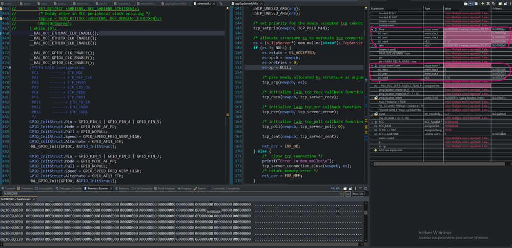

Have you enabled the lwIP debug messages, really helpful to check that via UART (I'm using UART TX DMA at ~1Mbps).
There's so much stuff going on... and lwIP's function "trees" in some parts are so terrible to trace.
2024-10-01 7:57 AM
Yes I did, that's how I figure why my TCP Server wasn't working anymore and how the mem_malloc() work.
The log said that it couldn't allocate memory for pbuf ("etharp_raw: could not allocate pbuf for ARP request")
