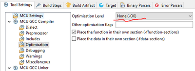

i have done a little debuging last night and i noticed if i use optimization level to none -O0 the DMA IRQ does not run. The systick irq runs
But if set optimization level to -O3 the DMA TC IRQ runs
