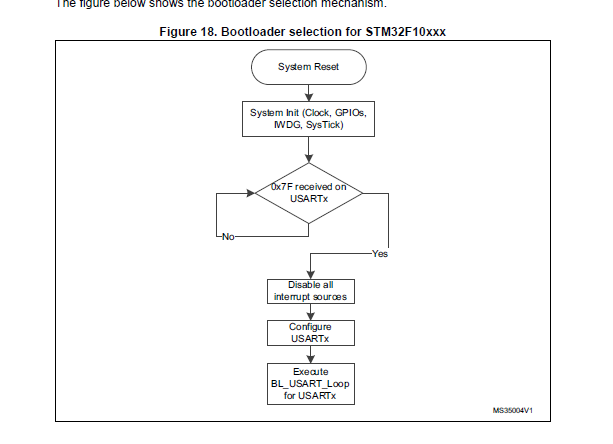

AN3154 discribes CAN protocol and applying it in supported devices, common for all mentioned Fx series, but AN2606 describes in details what channels are support. For STM32F10xxx only USART1 is supported.

2023-05-05 12:36 AM - edited 2023-11-20 6:25 AM
even the algorithm describes it:
