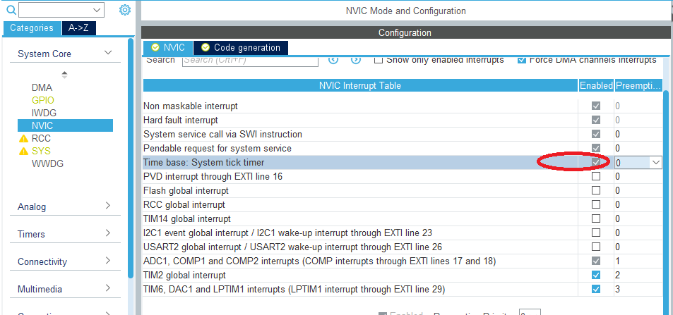

By Below Priorities setup , the code stuck in infinite loop and then hardfault

As @berendi replied, in main just call HAL_Delay. Unless you need delay while interrupts are disabled. Or unless you want more precise delay (microseconds). Just try it. Do not change the systick priority.

Ok ..Thanks .. But I also want to use high priority interrupt with HAL_Delay() and don't want to disable that like Pavel A. (Community Member) said ..
Karan
2020-06-30 12:29 AM
Do not use HAL_Delay() or any other kind of delay in interrupts.
