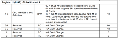

Reading the datasheet, I aspect to read something else from just 0xFFFF. Se foto where register 0x0B is something else than 0xFFFF.
