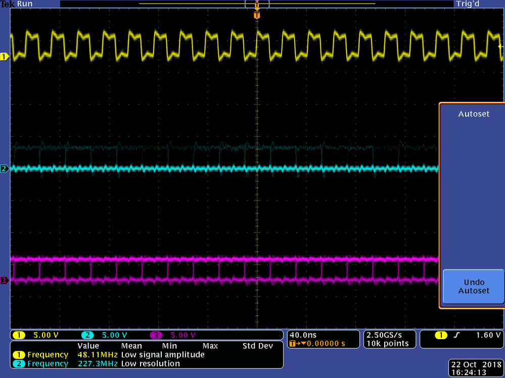

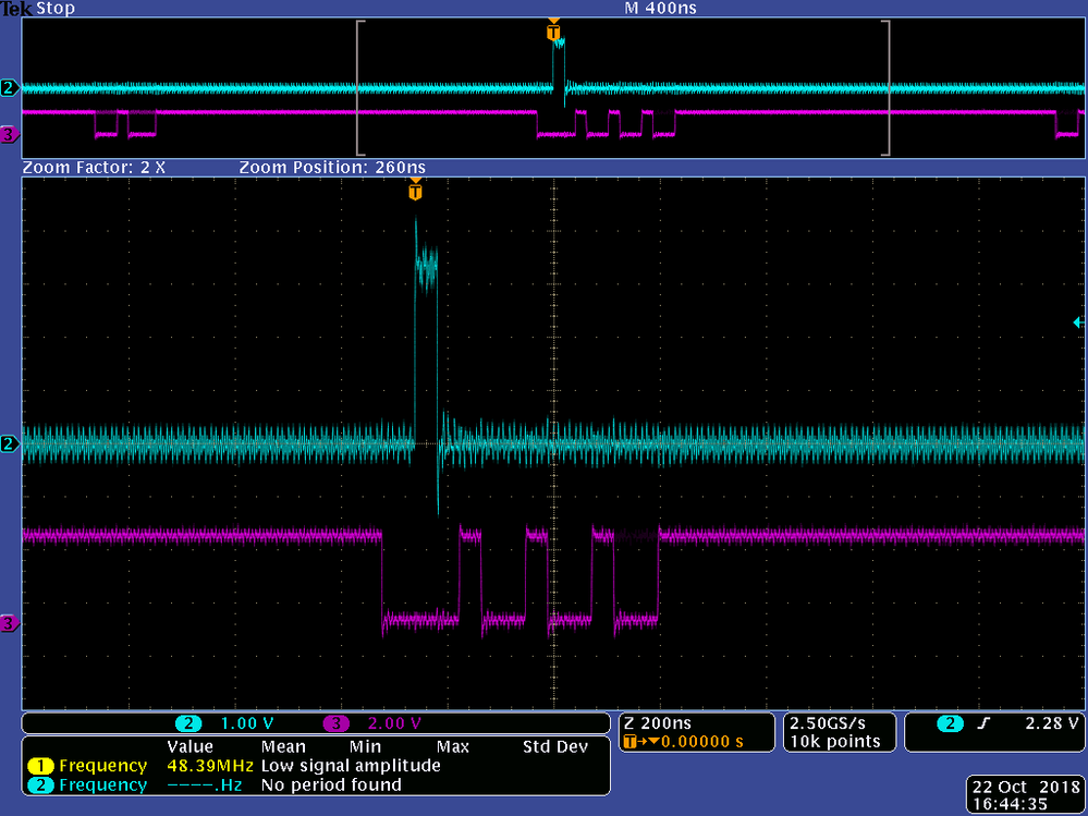

Hey @Community member I have reconsidered my options and it turns out it is necessary for me use FIFO. I decided to go for FMC as you suggested. My FIFO is synchronous so i have selected burst read write mode of PSRAM for building my FIFO controller. Since I m having a nucleo144 board with stm32f767zi , I decided to write a small test code for FMC based FIFO controller. My code has an array of type uint8_t and size 500. The content of array is like{0xFF,0x00,0xFF,0x00,0xFF,0x00,0xFF,0x00......... 500 times}. I send this to fifo using fmc and then observed the corresponding pins on oscilloscope. I expected the output to be somewhat like Fig 1 with write enable signal.
But I m not getting out as above. Please look at the following oscilloscope screenshots.
here the yellow wave is clock, My HCLK =96 MHz and FMC_CLK= HCLK/2= 48 MHz which is correct. The channel 2 (blue ) is data(only 1 bit that should go 0,1,0,1,0...and so on). It shows faint appearing and disappearing square pulses. Pink channel is Write enable signal.
My problem is when i trigger the oscilloscope for data signal and capture waves i see something like this.
so my data bit is high for 2 FMC_CLK instead of 1 . Further when i observe Write enable signal along with data signal i see this.
since WE(write enable ) is going low and high but data is not changing so garbage values will be pussed in FIFO.

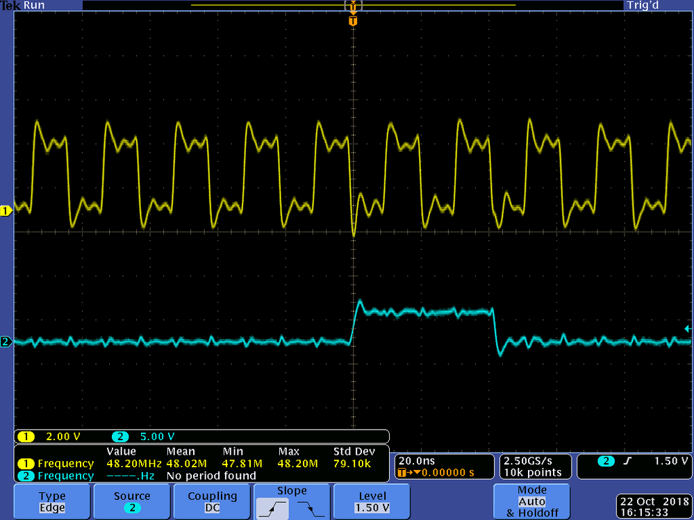

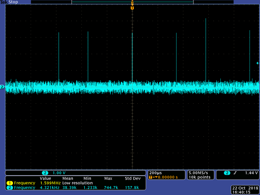

When i increase scale of oscilloscope and trigger the data signal i see this
The frequency of incoming data is very small.
Can you please have a look and help me out?

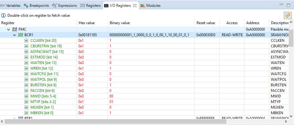

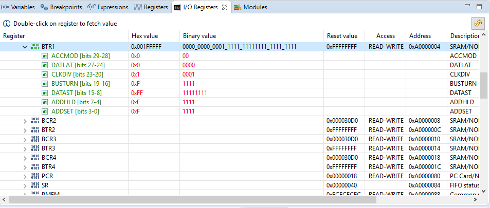

I have reffered to Ch 13 of RM0410 to check out the required configration of FMC_BCR and FMC_BTR registers. I have run my board in debug mode and checked the values of these registers. Have a look
This is the content of BCR register.
This is the content of BTR.
Please let me know what you think about it and how can this issue be resolved.

2018-10-24 3:27 AM
do you have A11 as the address strobe ?
the Ffo Address is 0x6000 0800 using A11 ?
I am confused, but thats ok...
you will learn by teaching me about your board.

can you see this section on the scope, its as tight as C can go. ( DMA would be faster or ASM)
this should be transfering at least 10MHz, that is max 0x1F4 length x 0.1uS = 50uS, is that about right ? on the scope ?
I glazed over your code.

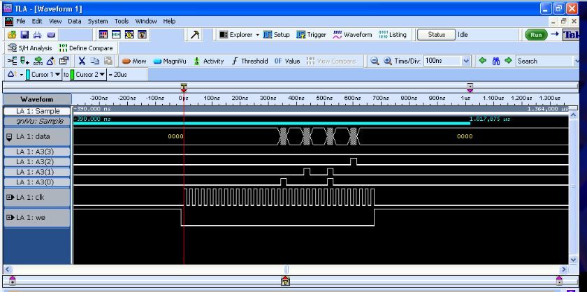

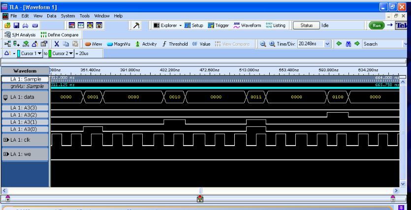

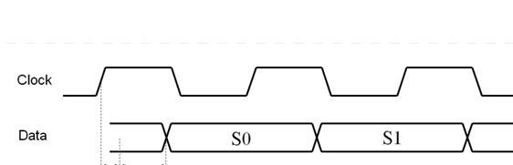

2018-10-30 1:44 AM
I modified my code as you suggested . Now I m sending 4 values and then waiting for 1 sec. I observed the output on logic analyser. In figure 1 i can see that data is coming in correct sequence ie 0X01,0X02,0X03,0X04.
But data is not coming out at every clock and also write enable is low . See Fig 2. Data is coming once in 4 clocks.
This will lead to writing of lots of 0X00 along with required data points. How can we get one data per clock ? Or How can write enable be low only when valid data is getting outputted?
2018-10-30 1:51 AM
Actually i dont need address since i want to write to a FIFO. But since i m using PSRAM controller of FMC for generating my waveforms hence i m forced to enable address. I m not clear about how all DMA channels are related to each other. Since ethernet is already using DMA. I dont want to mess with DMA here untill n unless absolutely necessary.

good work, the data looks great on the new scope.. nice and stable.
you seem to be writing a 32bit number @ 8 bits x 4 times. hence the 4 clock strobes.
