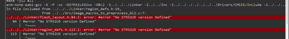

2025-03-17 2:39 PM
I need to run the example on STM32L432xx development board. Apparently, this board is not supported by this example. So, I manually added the drivers related to the STM32L432xx board in the respective locations. The updated command in the STM32CubeIDE is as under, I have also attached the updated project with the post.
arm-none-eabi-gcc -E -P -xc -DSTM32L432xx -DBL2 -I../../../Linker -I../../Inc -I../../../../../../../Drivers/CMSIS/Include -I../../../../../../../Drivers/CMSIS/Device/ST/STM32L432xx/Include -I../../../../../../../Drivers/STM32L4xx_HAL_Driver/Inc -o./output.ld ../STM32L432KCUX_FLASH.ld && arm-none-eabi-gcc -E -P -xc -DSTM32L432xx -DBL2 -I../../../Linker -I../../Inc -I../../Inc -I../../../../../../../Drivers/CMSIS/Include -I../../../../../../../Drivers/CMSIS/Device/ST/STM32L4xx/Include -I../../../../../../../Drivers/STM32L4xx_HAL_Driver/Inc -o../image_macros_preprocessed_bl2.c ../../Src/image_macros_to_preprocess_bl2.cThe file `image_macros_to_preprocess_bl2.c` is defining some address locations and I could not resolve that. It seems to be related to the specific memory layout of the board. I am getting the following error when trying to build my project.
Kindly help me in getting out of it. Or recommend me some easy way to integrate MCUboot to my STM32L432xx project.
