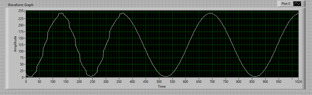

I am now able to send a buffer of 1024 binary data.
For simplicity (especially with LabVIEW) I shift to 8-bit of resolution for the ADC, still keeping 1µs of sampling period.
the code is here :
#define ADC_BUFFER_SIZE 1024HAL_ADC_Start(&hadc);
uint8_t ADC_buffer[ADC_BUFFER_SIZE ];
uint8_t ADC_Value_8bit;
while(1) {
for (int i=0;i<ADC_BUFFER_SIZE;i++){
while ( HAL_ADC_PollForConversion(&hadc,1000) != HAL_OK ){}
ADC_buffer[i]=HAL_ADC_GetValue(&hadc);
CDC_Transmit_FS(ADC_buffer,ADC_BUFFER_SIZE);
}} I am sampling a sinewave at 1 kHz, I join a screen shoot of the labview plot, as you can see, the begining is not good but after 370 bytes it is OK
and also we can see that the 1kHz sinewave is very well resolved.Do you know why the first 370 points are that strange ?
2018-12-28 10:02 AM
Congrats on getting data through to the PC.
One more thing to add is to check the return value from CDC_Transmit_FS(). Keep retrying that call until it returns HAL_OK. Without that check, if the USB interface is still busy (sending previous data???) you will lose the entire buffer's worth of data.
That strangeness at the beginning looks like your polling code is missing data from the ADC. Most likely this is due to one or more interrupt handlers taking longer than one ADC sample time. My best guess is that this is the USB interrupt handler. Your code snippets don't show when the USB interface is initialized and how much time passes from the USB init code until you try to send your data. It could be that the USB enumeration process is happening during those first data samples.
Two things to try:
(1) The quick and dirty test is the add a HAL_Delay(5000) call after your USBD_Start() call to give the enumeration process time to complete. This is a brute force hack but will confirm that this is the issue.
(2) In the long term, the correct solution is to use DMA for the ADC data. Then in your while() loop you extract data from the DMA buffer instead of calling HAL_ADC_PollForConversion() and HAL_ADC_GetValue().
One more improvement to consider - don't start the ADC conversion until the PC has actually opened the virtual COM port and is ready to receive data. There is some way to determine when the PC is connected (i.e. the enumeration has completed and the PC has opened the virtual COM port). I don't recall how to do that off the top of my head, but there have been posts on this forum that talk about that.
2018-12-28 10:26 AM
thanks Bob
is that the way to test if the usb is not bussy ? :
while(CDC_Transmit_FS(ADC_buffer,buffer_size) !=HAL_OK){}when I put a longer sampling time 252 cycles instead of 14, the strangeness at the beginning is less strong and restreint to the very begining. I don't understand the first trick (where should I put HAL_Delay(5000) ?) so I will try with DMA
