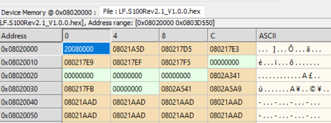

One more strange thing:
The value store in address 0x8020000 is 0x20080000 which mean if (((*(__IO uint32_t*)USER_FLASH_FIRST_PAGE_ADDRESS) & 0x2FFE0000 ) == 0x20000000) will return false condition. That 's why my bootloader can't jump to my app.

Sorry, my bad. I tried to change mask value from 0x2FFE0000 to 0x2FF00000 , so I can jump from bootloader to app. But I don't think it is correct way.
BTW, If I compile the code in Keil C, I have different first 4 bytes in flash (0x20008098) which is satisfy bootloader requirement (0x20008098 & 0x2FFE0000 =0x20000000). Isn't it weird?
