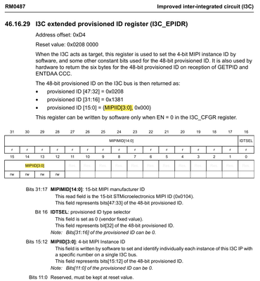

I'm creating an I3C target device. It uses an STM32U385RG as the microcontroller. According to the reference manual most bits of the Provisional ID are fixed and cannot be configured. This doesn't seem to allow for creating an I3C target device using my own MIPI manufacturer ID. Is that correct? Or is there some other way to provide a fully customizable Provisional ID?
If not configurable this seems like it makes the Provisional ID useless as it will be identical for all I3C target devices from all designers at all companies...

You have 4 bits available to change within the provisioned ID. This gives 16 different devices of this type before you run into conflicts. The other bits are fixed at the defaults for this chip as given below.

That was my reading of the data sheet also.
This seems close to useless for those of us trying to implement I3C target devices as we cannot identify them as ours and embed our extended information as seems to be the whole purpose of the provisional id as defined by MIPI.
Would be great if all 48-bits were all read/write in future silicon...

Looks like ST is just following the guidelines here. 4 bits seems low to me too. I don't see a reason why the lower 12 bits are fixed.
