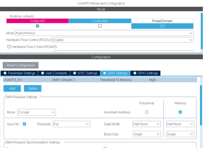

we are trying to integrate INMP441 microphone on Nucleo H755ZI-Q board via I2S2 and USART3 through DMA.
I2S2 configuration:
Clock configuration:

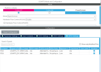

USART3 configuration:

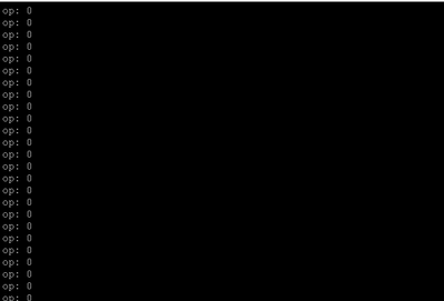

Output:
We tried to get the audio signals via I2S DMA through ping-pong buffer, the serial monitor output we are getting is just zeros.

Please take a look at this FAQ "DMA is not working on STM32H7 devices" , precisely "3. Solution example 1: Simple placement of all memory to D1 domain" section and "4. Solution example 2: Placing buffers in separated memory part" section, may help you to solve the issue.
