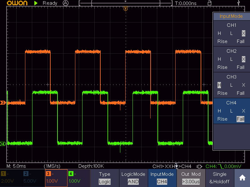

I did check it how you advised though. I toggle some pin (ch4) when I finish reading and converting data from the external flash, and togggle another pin (ch3) when I finish transmission of previous chunk of data.
The chunks read from flash and sent through I2S are the same of size:
256, 8-bit read from the flash, converted to 128, 16-bit.
128, 16-bit sent through I2S
As you may see on the screen shot appended, 'normal sittuation' is when:
ch4 rising edge is on high level ch3
and
falling edge of ch4 is on low level ch3.
I was trying to trigger for following events:
ch4 falling edge on high level ch3
ch4 rising edge on low level ch3.
These never happen, so I persume, that conversion of SPI Flash data is always finished before beginning of I2S transmission.
Should I provide some flow diagram or state machine to make it more clear?
Privately I could also share some code I believe.

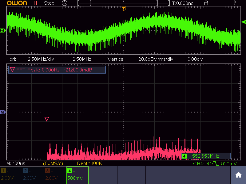

That's 1kHz sine wave that was sent via I2S to UDA1334 DAC, with it's FFT. Looks pretty awful too me, although it sounds pretty much like a 1KHz wave... I think it shouldn't look like that though. It looks pretty much the same with and without load. As load I am using BT speaker, connected via aux cable, powered of internal battery.
I think I will use some spare time to check if values sent via SPI I2S are the same and whether they create a nice clean sine wave at all. What do you think?
It's easier to check something simpler, e.g. a sawtooth. It's also easy to generate - simply store an incrementing value to the output buffer.
