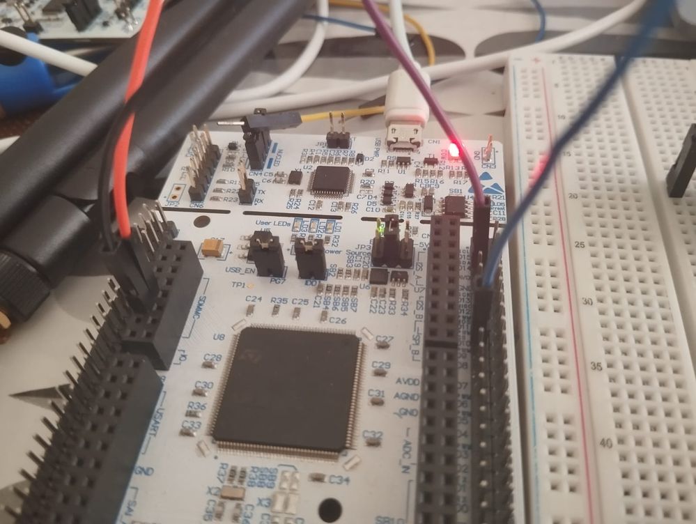

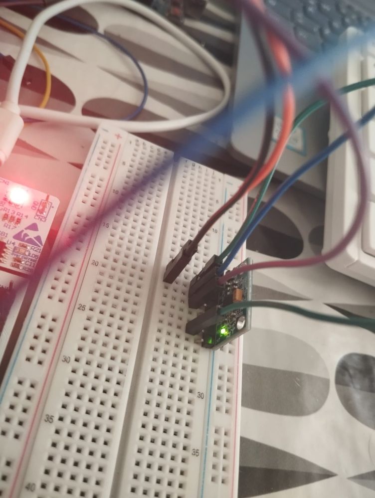

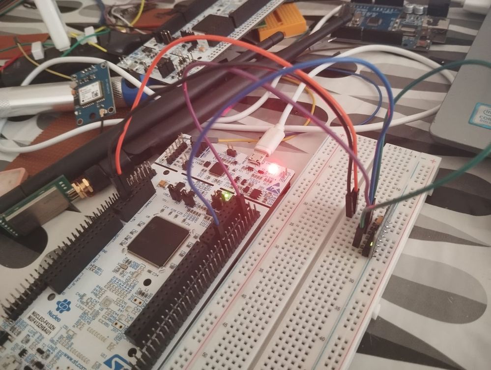

This seems like a continuation of this thread:
Did you ever observe what's happening on the I2C lines - with an oscilloscope ?
As @TDK said in that thread, the HAL_BUSY return likely means that one/both line(s) is being held low - you would be able to see that on an oscilloscope.
I can't see that you ever confirmed what board you're using - was @Dazai correct in assuming NUCLEO-F413ZH ?
How is your I2C slave connected to the board? long trailing wires? breadboard? other??
Some good, clear photos of your setup would help.
2024-08-01 7:21 AM - edited 2024-08-01 7:33 AM
