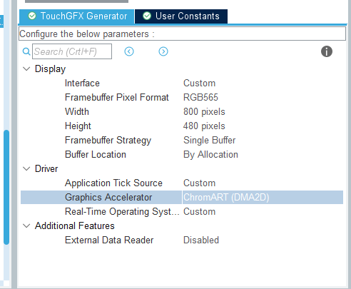

I want to use TouchGFX with AzureRTOS(Thread X).
※board is STM32F769DISCO
※TouchGFX Version is 4.16.0
I made stm32CubeIDE's project with TouchGFXDesigner.
(selecting board→making Screen→Gnerate Code)
I opened this project with STM32CubeIDE.
Next, I disabled FREERRTOS and set X-CUBE-TOUCHGFX.After that, I imported and refered some files related to ThreadX.
Next, I added some code refering to azure rtos's page in touchgfx guide,
and I write "hal.taskEntry();" in touchgfx_taskEntry() function.

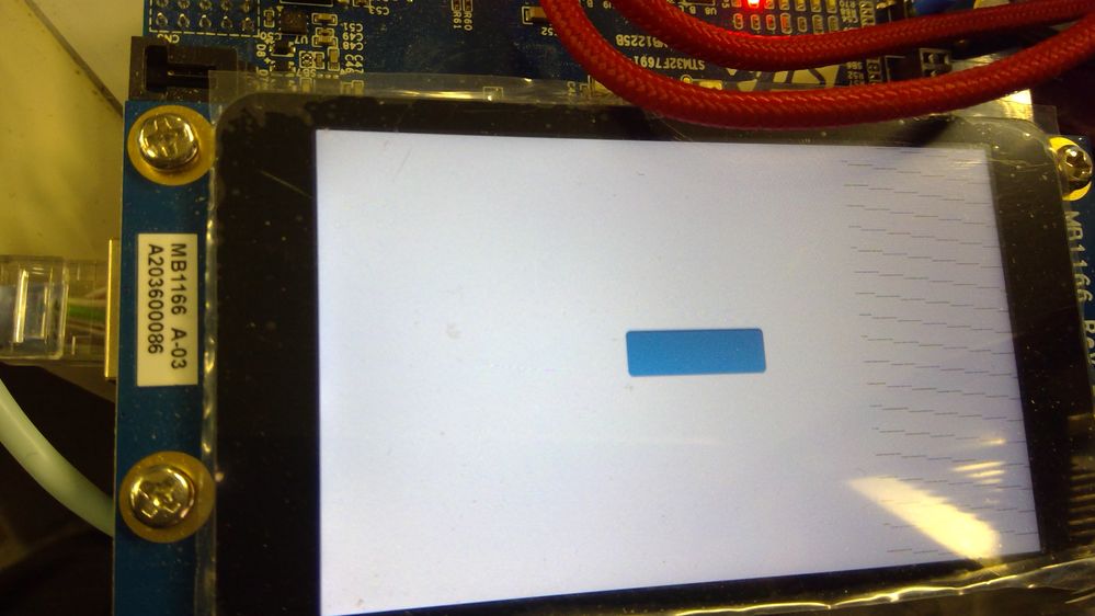

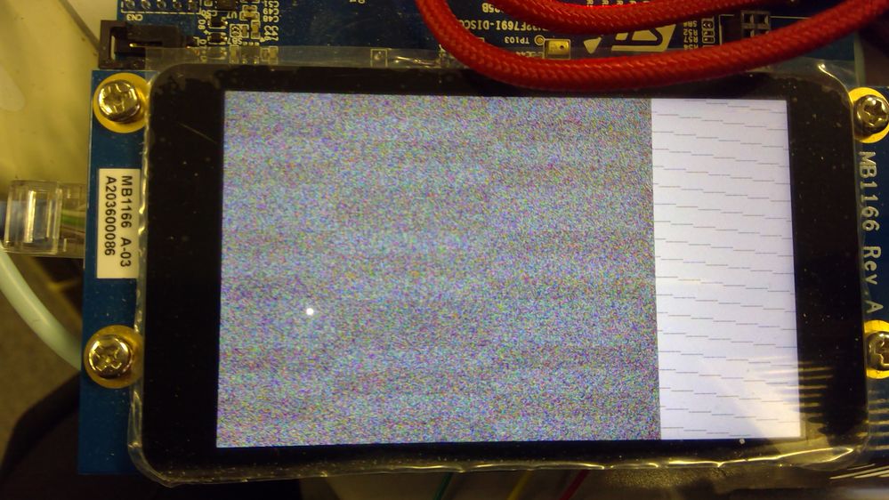

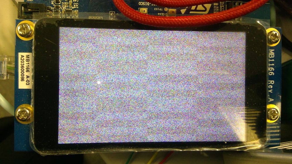

I tried to run this project. The result is as follows.
But, when I enabled breakpoint in "OSWrappers::waitForVsinc()"in TouchGFXHAL::taskEnry() and debugged this project,
I pushed resume button sometimes.
This picure is my expected screen.
I don't understand why this phenomenon occurs nor what I should do.
