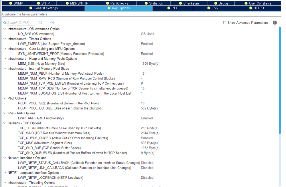

Please, help me resolve this problem.
LWiP settings in CubeMX:
