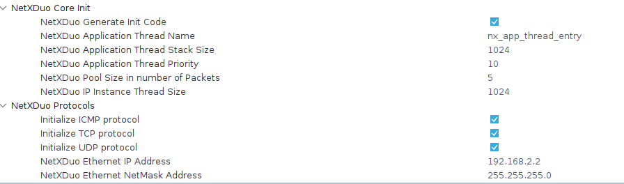

Here is my feedback:
1) I Do Not see a "Common Init" feature, but I do see in the NetXDuo Core Init this:
As you can see here, I do not see a check box to disable DHCP.
Perhaps I need an updated version of CubeIDE/MX or perhaps there is significant detail you have not revealed.
