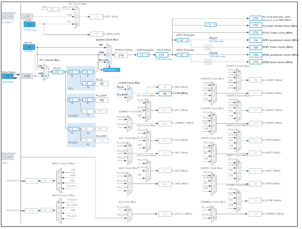

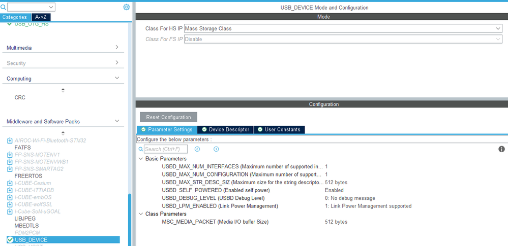

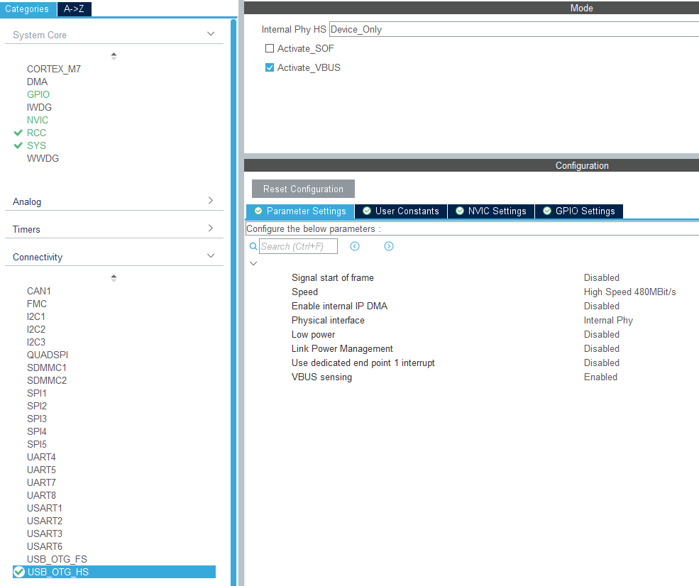

Project Setup:
Linker Settings:
Minimum Heap Size 0x2000
Minimum Stack Size 0x2000
This is are all configuration I made. The rest is set to default when you start a new project with the project wizard. The IOC File is also attached to this post.

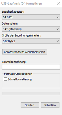

After building and running the FW the host computer (Windows 10) detects a new storage device and shows this message (german):
It say's you have to format the device before using it.
If I do so:
I'll get this error message which says: Windows could not complete the formatting
I have also tried to format the device on an Linux host which also failed.
