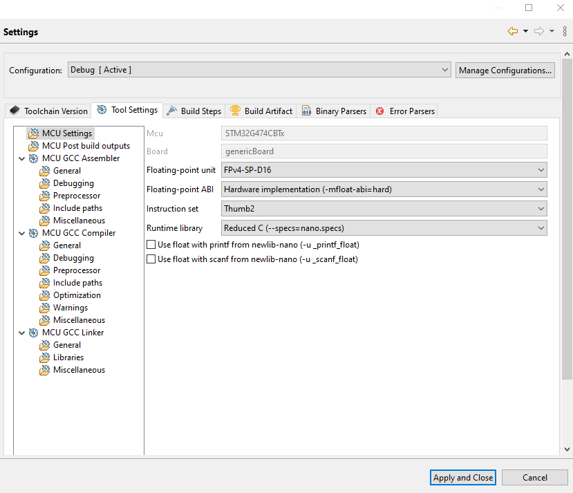

Thank you , I will try direct reg, but I am also surprised at LL being that slow. There must be something that I am missing. The clock is 172 MHz and I am using STM32G474 with FPU. I have just been migrated to STM32 and still trying to figure things out.
2021-01-03 7:47 AM
I am using STM32G474 and turned FPU ON. I have another equation with division and multiplication in IR which goes pretty past (relatively).
