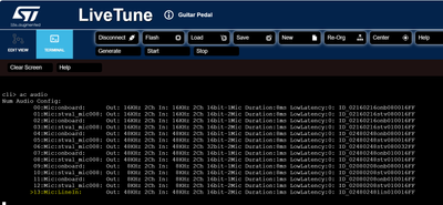

cli>ac audio : List all configuration available. ( screenshot 1)

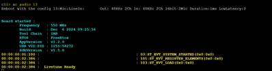

cli>ac audio 13 : Select the Mic:Line  as configuration and reboot  ( screenshot 2 )
screenshot 1screenshot 1
screenshot 2screenshot 2
-->  Now, the LineIn configuration is complete.
