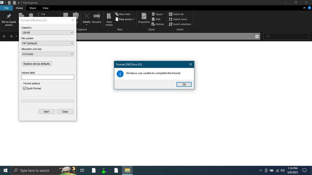

2023-03-08 11:57 PM
I'm allocate 128KB Flash block size, but file not created and unable to complete the format. https://github.com/ankitdevganiya13/STM32_USB_MSC_FATFS/tree/master
2023-03-09 12:02 AM
Sir, I'm allocate 128KB Flash block size, but file not created and unable to format.

Hi @ADevg.1
IIRC, you are configuring the STM32 as an USB storage device and want to write data using the windows machine on the internal flash of the STM32?
is this correct?
