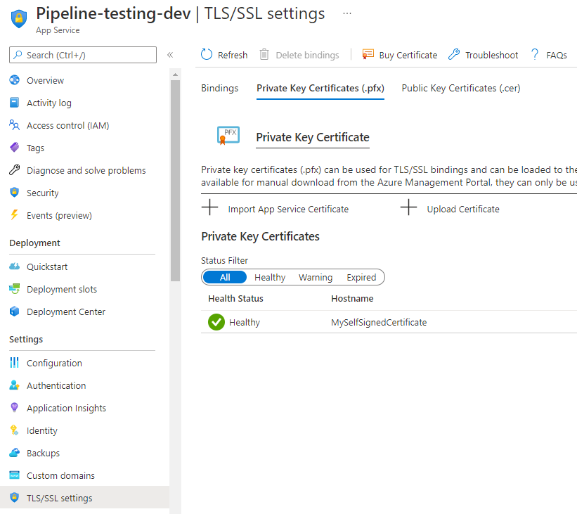

}So, I have a certificate on Azure app service :
I would like to know how to add it in my code. It seems I have to download it in .pem format but I do not know how to do it.

This is confusing. X-CUBE-AZURE purpose is to connect an IoT device to an Azure IoT Hub.
You are talking about an Azure App Service certificate. So it is not the same thing .
