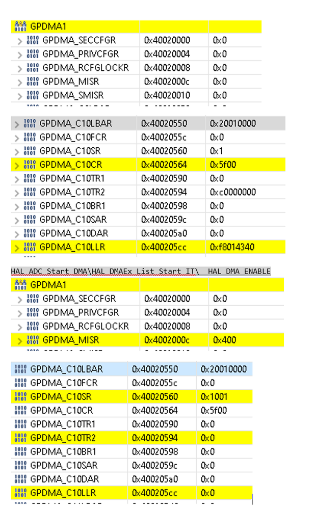

our porject use TZEN =1;
A custom Bootlaoder (secure app) is executed at begin and after we call a non secure Application.
The non secure Application as already been tested/validated with TZEN = 0.
This application use GPDAM channel 10 ro read data from ADC4.
With TZEN = 1 , HAL_ADC_Start_DMA is not wroking.
I Put GPDMA register config arround __HAL_DMA_ENABLE
DMA return USEF error.
Does anyone has an idea of why it fail?
SRAM 1-2-3 are configure as non secure (application can read/write inside it).
All peripheral are configured as non secure from Bootloader
HAL_GTZC_TZSC_ConfigPeriphAttributes(GTZC_PERIPH_ALL, GTZC_TZSC_PERIPH_NSEC|GTZC_TZSC_PERIPH_NPRIV)This is DMA node configuration :

ret |= HAL_DMAEx_List_InsertNode_Tail(&ADC4_Queue, &ADC4_Node);I don't understand why it fail:
