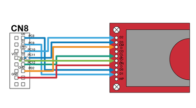

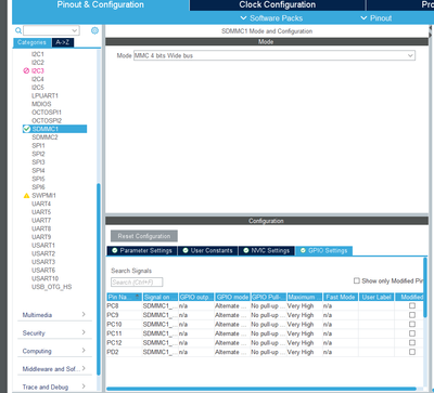

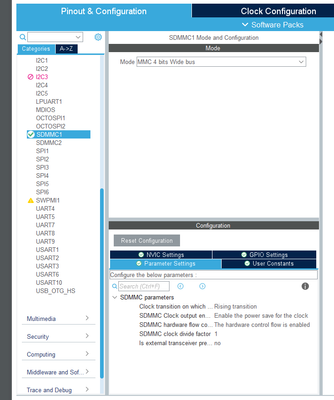

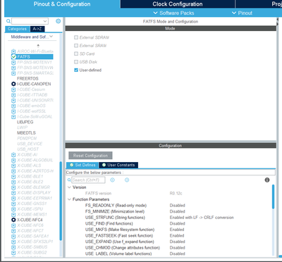

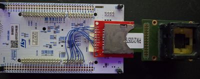

After connecting an SD card reader to the CN8 connector on the Nucleo STM32H723 board and using an eMMC card reader, the FATFs system is reporting that the eMMC is not ready. I am encountering problems when performing operations like f_mkfs or f_mount, receiving a "Not ready" error. Despite numerous checks of the configurations and parameters, I have not been able to resolve this issue.

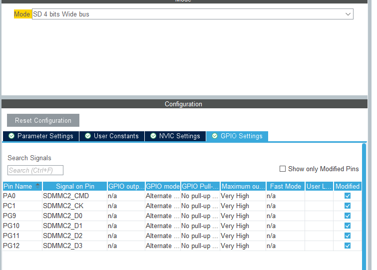

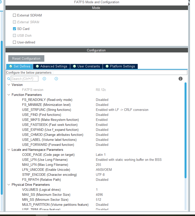

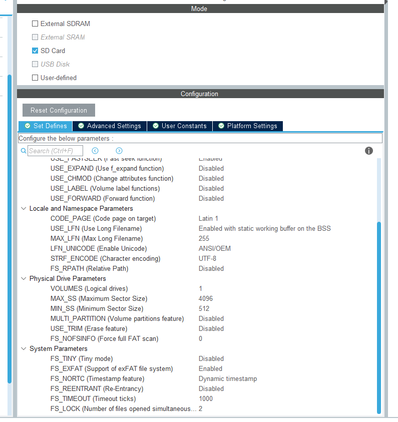

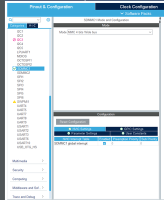

I have tried all your recommendations for the Nucleo-H723ZH (STM32H723), but the FATFs system consistently reports that the eMMC is not ready. I also purchased the Discovery board STM32H735IGK6. When I use the provided examples for a micro SD card, it works, but when I reconfigure it with Cube-MX for an eMMC and follow all the recommendations you mentioned, I encounter a new issue: the FATFs system reports that the FR_INVALID_DRIVE.
2024-05-01 5:01 PM
go with SD not MMC
probably something wrong with your settings, some SD cards will not work
I have the same setting on a few boards, all is working

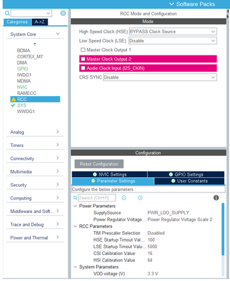

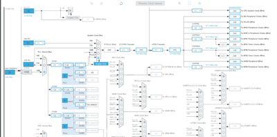

what is your clock in CubeMX for SD ? on my cards it works up to 48 MHz, stops above
